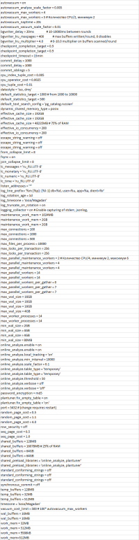

(0) postgresql.conf хотя бы показал.

(12)
Подробностиautovacuum = on autovacuum_analyze_scale_factor = 0.005 autovacuum_max_workers = 4 autovacuum_max_workers = 5 # Количество CPU/2, минимум 2 autovacuum_naptime = 20s autovacuum_vacuum_scale_factor = 0.01 bgwriter_delay = 20ms # 10-10000ms between rounds bgwriter_lru_maxpages = 400 # max buffers written/round, 0 disables bgwriter_lru_multiplier = 4.0 # 0-10.0 multiplier on buffers scanned/round checkpoint_completion_target = 0.9 checkpoint_completion_target = 0.9 checkpoint_timeout = 15min commit_delay = 1000 commit_delay = 1000 commit_siblings = 5 cpu_index_tuple_cost = 0.005 cpu_operator_cost = 0.0025 cpu_tuple_cost = 0.01 datestyle = 'iso, dmy' default_statistics_target = 1000 # from 1000 to 10000 default_statistics_target = 500 default_text_search_config = 'pg_catalog.russian' dynamic_shared_memory_type = posix effective_cache_size = 192GB effective_cache_size = 192GB effective_cache_size = 48235MB # 75% of RAM effective_io_concurrency = 200 effective_io_concurrency = 200 escape_string_warning = off escape_string_warning = off escape_string_warning = off from_collapse_limit = 8 fsync = on join_collapse_limit = 8 lc_messages = 'ru_RU.UTF-8' lc_monetary = 'ru_RU.UTF-8' lc_numeric = 'ru_RU.UTF-8' lc_time = 'ru_RU.UTF-8' listen_addresses = '*' log_line_prefix= '%m [%p]: [%l-1] db=%d, user=%u, app=%a, dient=%r' log_rotation_age = 1d log_timezone = 'Asia/Magadan' log_truncate_on_rotation = on logging_collector = on # Enable capturing of stderr, jsonlog, maintenance_work_mem = 1024MB maintenance_work_mem = 2GB maintenance_work_mem = 2GB max_connections = 100 max_connections = 1000 max_connections = 500 max_files_per_process = 10000 max_locks_per_transaction = 256 max_locks_per_transaction = 256 max_parallel_maintenance_workers = 2 # Количество CPU/4, минимум 2, максимум 6 max_parallel_maintenance_workers = 4 max_parallel_maintenance_workers = 4 max_parallel_workers = 14 max_parallel_workers = 14 max_parallel_workers_per_gather = 0 max_parallel_workers_per_gather = 7 max_parallel_workers_per_gather = 7 max_wal_size = 16GB max_wal_size = 16GB max_wal_size = 16GB max_wal_size = 4GB max_worker_processes = 14 max_worker_processes = 14 min_wal_size = 2GB min_wal_size = 4GB min_wal_size = 4GB min_wal_size = 80MB online_analyze.enable = on online_analyze.enable = on online_analyze.local_tracking = 'on' online_analyze.min_interval = 10000 online_analyze.scale_factor = 0.1 online_analyze.table_type = 'temporary' online_analyze.table_type = 'temporary' online_analyze.threshold = 50 online_analyze.verbose = off online_analyze.verbose = 'off' password_encryption = md5 plantuner.fix_empty_table = on plantuner.fix_empty_table = 'on' port = 5432 # (change requires restart) random_page_cost = 0.5 random_page_cost = 1.1 random_page_cost = 4.0 row_security = off seq_page_cost = 0.5 seq_page_cost = 1.0 shared_buffers = 128MB shared_buffers = 16078MB # 25% of RAM shared_buffers = 64GB shared_buffers = 64GB shared_preload_libraries = 'online_analyze, plantuner' shared_preload_libraries = 'online_analyze, plantuner' standard_conforming_strings = off standard_conforming_strings = off standard_conforming_strings = off synchronous_commit = off temp_buffers = 128MB temp_buffers = 32MB temp_buffers = 512MB timezone = 'Asia/Magadan' vacuum_cost_limit = 500 # 100* autovacuum_max_workers wal_buffers = 16MB wal_buffers = 16MB work_mem = 32MB work_mem = 512MB work_mem = 9586kB work_mem=512MB Это текущий, но конфиг всяко разно переписывали, результат ваще нулевой ((
